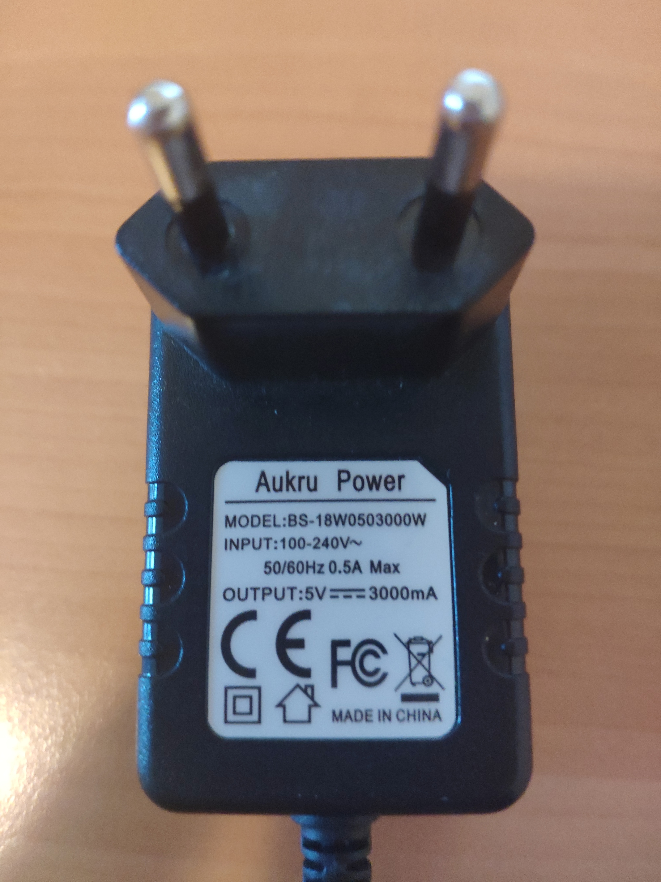

Can we use a power source of 5V/3/A?
This link says that it has to be 5V/2A…

Yes you can use that power supply. However a stable voltage is required. The official raspberry pi 3 power supply is recommended.

I have this. How can I know if the voltage is stable?

The best answer is more capability the better. A 2 or 3 amp source will both power the Dreamcatcher. Ken

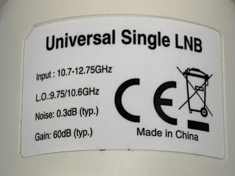

This picture comes from the presentation page of the Dreamcatcher v3.05.
I would like to know what is “noise” and is it better when the number is huge or tiny? I have the same question about “Gain” x).
Also, what does mean the “single” in “universal single lnb”?
Moreover, where should be written 4K?

Small number is better.
“Single” means one antenna element inside.
Ignore the reference to 4k.
