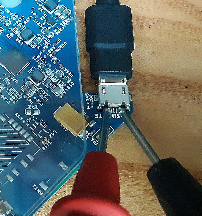

@kenbarbi The points you asked about will show you 5V, but those pins are post-PMIC, so it will show a regulated 5V output. I just measured it at 5.02V.
The pins on the microUSB connector will show you exactly what is coming into the board before being sent through a power management IC. Even some fat probes from a generic multimeter should be able to pick up the outside pins on the microUSB connector. When I measure at that location, I get 5.12V.
Oh OK - - good to know. Right now, I have stripped back a USB cable exposing my + and - so I can measure it in its native mode! Ken

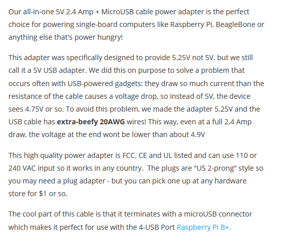

Just a word of clarification on 5.25 vdc 2.4 amp USB power supplies from one company that sells them for about $8 - -
The PMIC used in Dreamcatcher is the Allwinner AXP209. Here is a link to the datasheet.
But there is another component in there which doesn’t like more than 5.5V.
I think these devices are at most 5.25 vdc. I’m going to try one to see what happens. Ken

Here’s a picture of what you mean. I think this measurement is important for other Forum members who are experiencing Dreamcatcher start up problems to measure their input voltage. I’m adding it to the User’s Guides too - - Ken

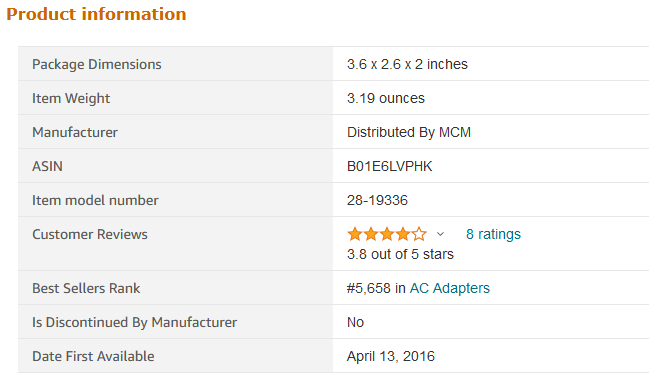

I received and installed a $7 Regulated Raspberry Pi Power Supply from Amazon to drive the Dreamcatcher - -
Here are its specs:
Hopefully I’ll never have another failure! Ken
Checking various sources, then, USB standard is 5.0 ± 5% = 4.75 to 5.25v, so knowing the problems with the Dreamcatcher that begin at 5.0 and lower, the limits for the Dreamcatcher are 5.0 to 5.25 volts dc?
