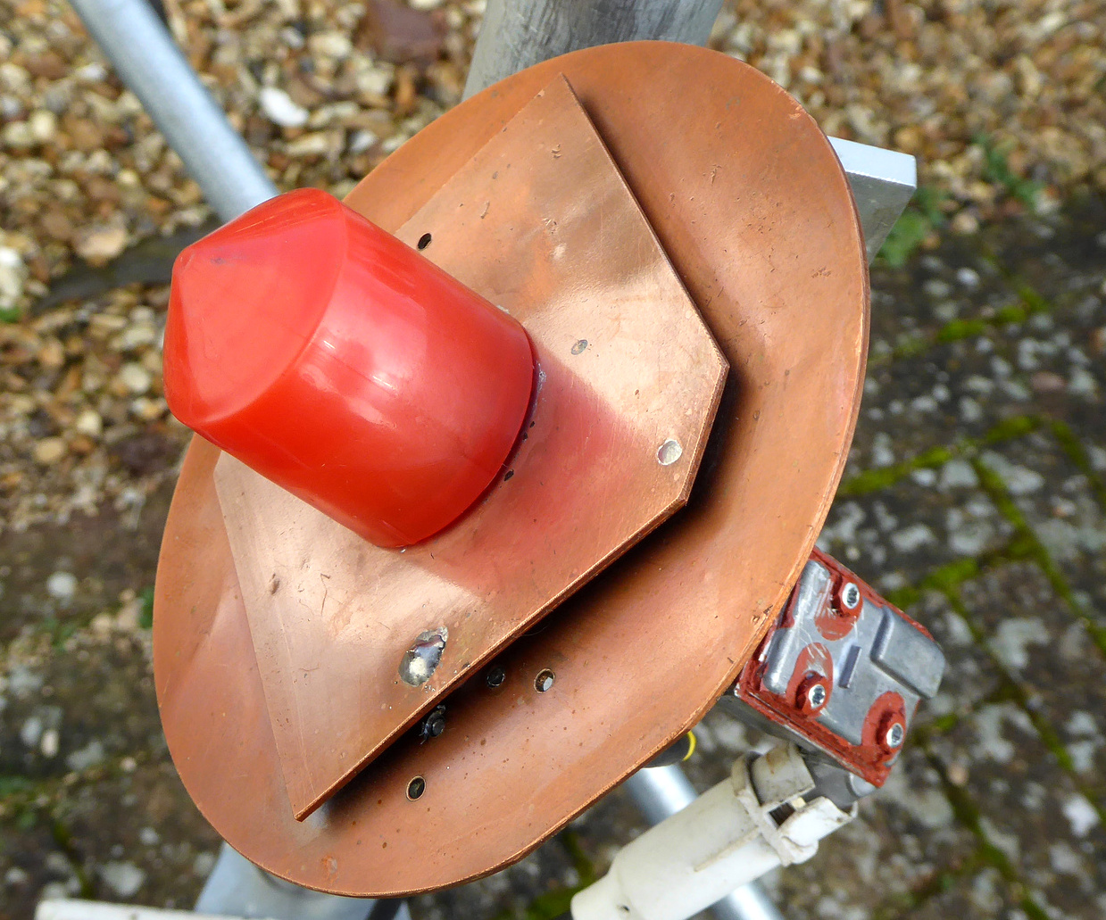

Measured my 18" dish… from the center of the dish… between to the two bolts. to the closest edge of the plastic lnbf cover is 11", the larger part of the lnb plastic mount is 14" from that same center of dish. So… the focal point must be somewhere in that vicinity …

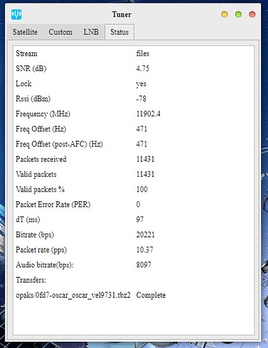

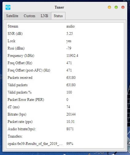

I replaced the circular Dish LNB with the Maverick and am now running at 4.5 to 5.25 dB SNR and -78 RSSI vs 1dB SNR and -87 RSSI with the circular LNB.
Now that I know this works and the proper positioning I will be testing the Universal.
Thanks for the measurements. The Maverick SNR doesn’t vary that much in the 11 to 12 inch range from dish center. However, the skew setting is much different than when used with the horn. Securing the LNB bracket was makeshift – just a C-clamp, but stable enough for testing.

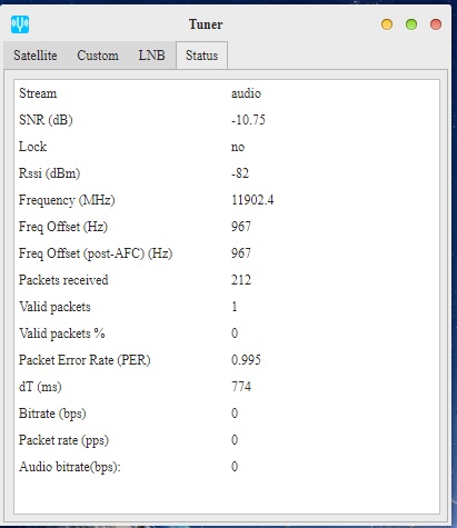

On the DISH antenna, the Universal produced a SNR of less than -10dB regardless of skew and experimenting with the LNB orientation and distance from the dish. I am using the same bracket in the same position as used for the Maverick. Previously I had confirmed that the bracket had the same tilt as the original DISH installation, and took relevant measurements to allow at least a good starting position.
Since the dish had been accurately aimed last week for my test with the original circular LNB, there was no reason to recheck that. Results with the Maverick also proved the aim was good.
All of this is surprising and makes me wonder if we have a defective unit.
Would welcome any suggestions or if you can think of anything I might have overlooked.

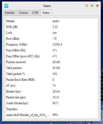

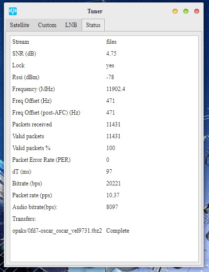

Tuner status for both below.
Universal
Maverick

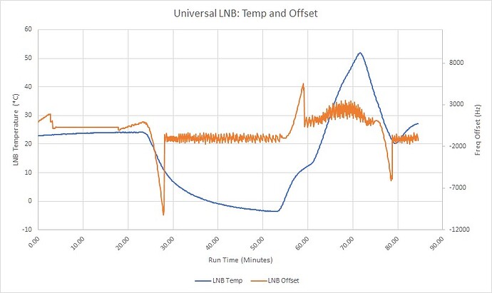

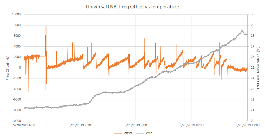

Another 12hr test performed, this time with temperature logging.
Results look about the same as before, regarding relative performance of Maverick vs Universal and Universal Freq Offset. Heat Rise of both LNBs measured 2*C in my setup. I taped the temperature probes to the rear flat surface of each LNB (directly opposite the feed-end).

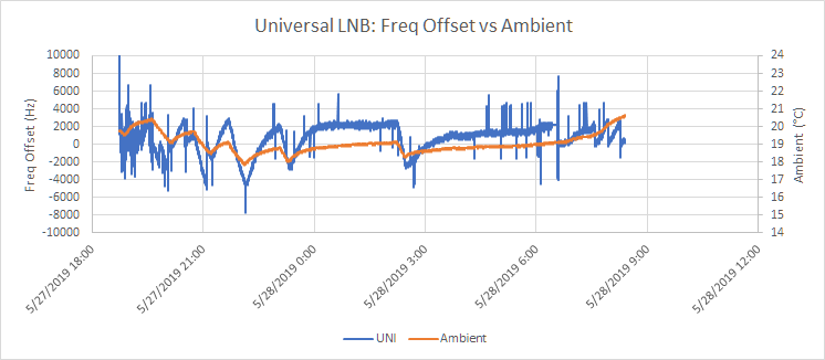

I am continuing to have overall bad signal quality in recent days/weeks. When I first started with the DC (March or April of this year) seemed like I could reliably get -9 and -10 dB SNR readings without hardly trying. Nowadays, it hovers around -14dB and as the plots in the attached PDF show, bitrates and lock are way down.
Here is today’s report: Universal_Test_20190528.pdf (519.6 KB)
I guess one interesting thing I saw is the correlation between Freq Offset and Ambient:
A degree or two of temperature swing really makes the freq offset take off.
EDIT: Eyeballing the graph, looks like about 0.4 PPM / *C. This seems in line with an uncompensated AT cut xtal (no idea what style the LNB uses however).

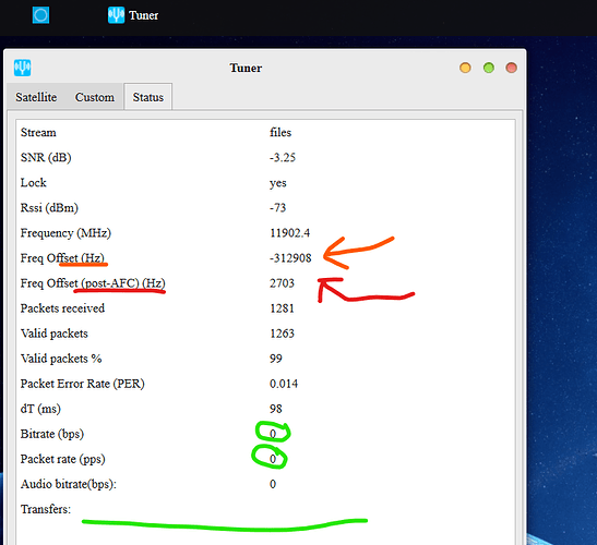

I can confirm this, that non-AFC and post-AFC values always match. On the most recent run, I logged over 14k data-points on each LNB, and they all showed non-AFC == post-AFC
And based on the frequency offset corrections that correlate with ambient temperature shifts I see in the data I’m taking, I believe both values are the post-AFC value.
This brings up two problems with the ‘tuner status’ screen on Skylark 5.5
  1. The screen is blank until the first packet is decoded as valid. This makes initial setup a real random effort. Meaning… no flashing leds, no status screen, no feedback on what is happening in the receiver.
  2. Since the status appears to be only “post-AFC”, there is no operator assistance in trying to fine tune the custom frequency setting for the lnbf. Thus, trying use a lnb that is not in the ‘table — maverick or othernet dual band’ is constrained. It leaves the end-users with few tools.

I moved the Universal LNB to my indoor 18" dish. Once I dialed in the distance and height of the LNB relative to the dish, and adjusted the skew, I was seeing -1 dB SNR and -77 dB RSSI. Fairly comparable to when I had the Maverick on there.

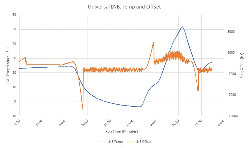

I was doing a test assembly of my prototype thermal chamber onto the Universal LNB mounted to my 18" dish, and ended up making an impromptu run.
Even during the higher offset excursions than I’ve seen before, the two numbers coming out of Skylark matched the entire time (pre and post AFC)

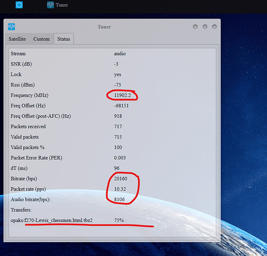

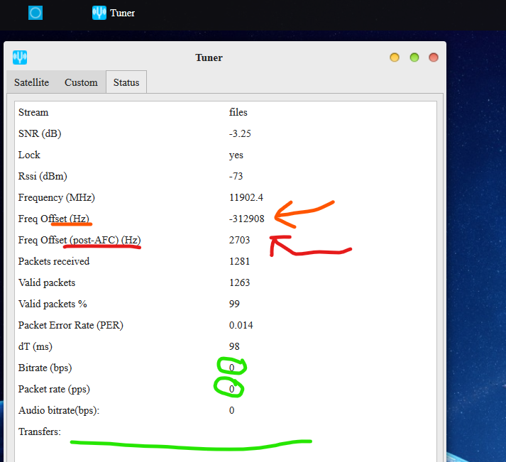

found a copy of skylark-dc-v5.4-1810251245 … It had different AFC frequency offset responses… still testing

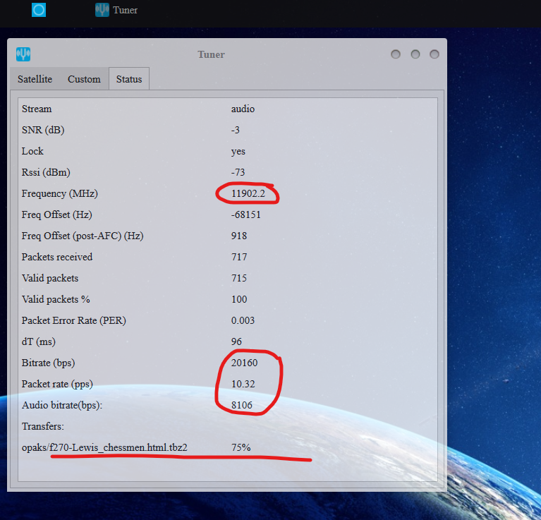

Here is using 5.4
first snip is using default freq. … note using a dro non-pll lnb and it has
no data rate using default frequency
next after custom adjusting the frequency… the AFC corrects the signal and starts decoding
