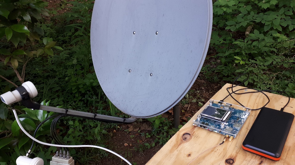

Need some clarification. I have been testing the Maverick and the new Universal LNB on my Dreamctcher indoors 500 feet away from my LNB/Dish, and outdoors at the LNB/Dish as this pic illustrates with the Maverick live, and the universal and Invacom hanging below waiting their turn - -
For the Dreamcatcher indoors and outdoors tests, the Maverick has provided higher SNRs than the Universal by about 3 dB. Both are receiving the same Rssi levels (indoors they both receive -103 dBm and outdoor they both receive - 69 dBm). No problem getting lock, and my bitrates climb rapidly to 20,000 bps.
