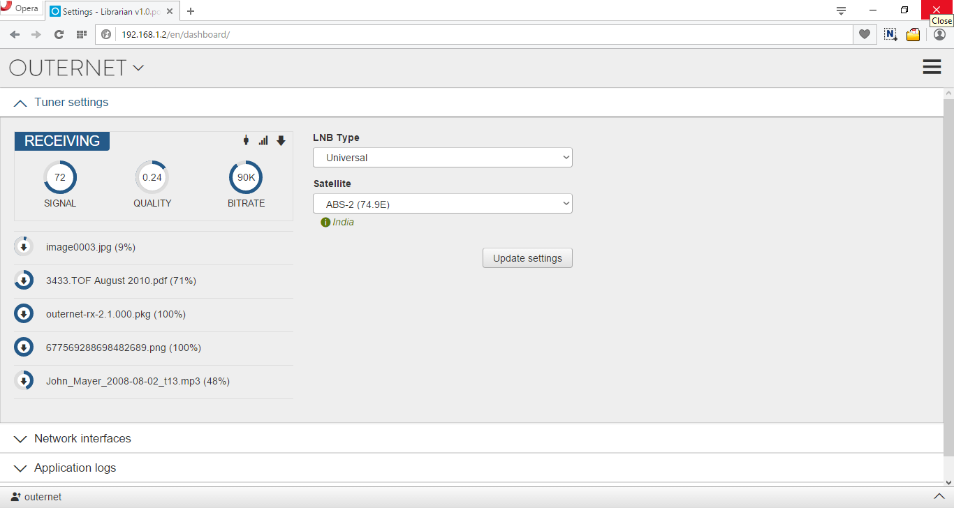

Few minutes ago I started (a restart after 12 hours) my Pi again. Librarian started but no signal lock. I connected external hardware in different combinations and restarted the Pi several times but still unable to get the signal lock.
EDIT: I removed the SD card from the Pi and inserted it to my PC’s SD card slot. But no errors found. I ejected the card and inserted again to the Pi.
Now it is working
I think this is because of oxidation between sd card and sd slot contacts. But I have to do this for every restart. Actually no need to insert the card in to PC. Insert in in to a SD adapter is enough.
My question is why this (oxidation, if I’m correct) is only related with the signal lock.
That’s a rather far-fetched conclusion. I wouldn’t say those are related. It’s probably something else, but hard to say without obtaining a sample tuner that works exactly the same way as yours.
