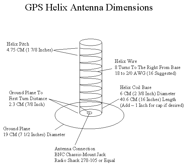

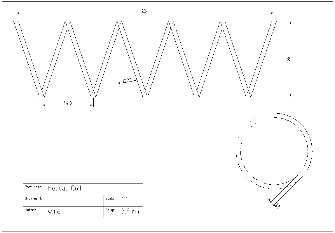

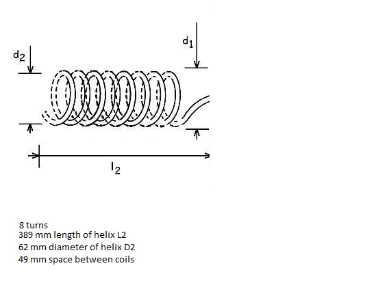

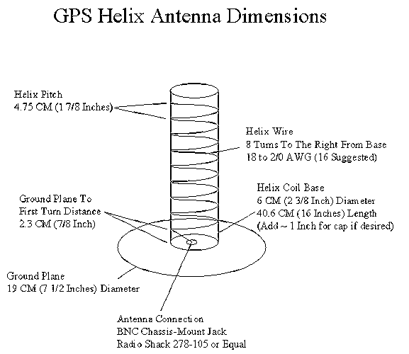

The next design is going to be based on a ceramic patch, since that will considerably reduce the cost and size of the entire receiver. Our colleague Zoltan made a 6-turn helical that worked really well. Iâll ask him to upload what he did. In the meantime, here are some old designs we were working on.
If there is enough customer demand, we will definitely consider it. But it may be better for people to make it themselves. But it wonât be omnidirectional, as anything that provides ~6dBi of gain is directional.
