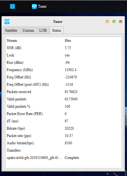

I’m using 500 ft of low loss RG-6 cable (the kind Comcast uses in buried installations) with my Maverick on an 80 cm offset FTA dish. Here’s my Tuner App data - -
Inside, at this time, I have a -94 dBm Rssi. At 1 GHz, standard RG-6 has about 6 dB loss per 100 feet. When I connect my Dreamcatcher outside, I get -74 dBm Rssi. An expected 20 dB drop - - usually my signal levels are more on the order of -102 dBm. All other signal parameters are the same - - especially the SNR. Ken
As there are no errors there is enough signal and signal quality. On my 40m run I experimented with a line powered amplifier half way and determined the results were better without it. This on TV as my dreamcatcher is ordered but not seen.

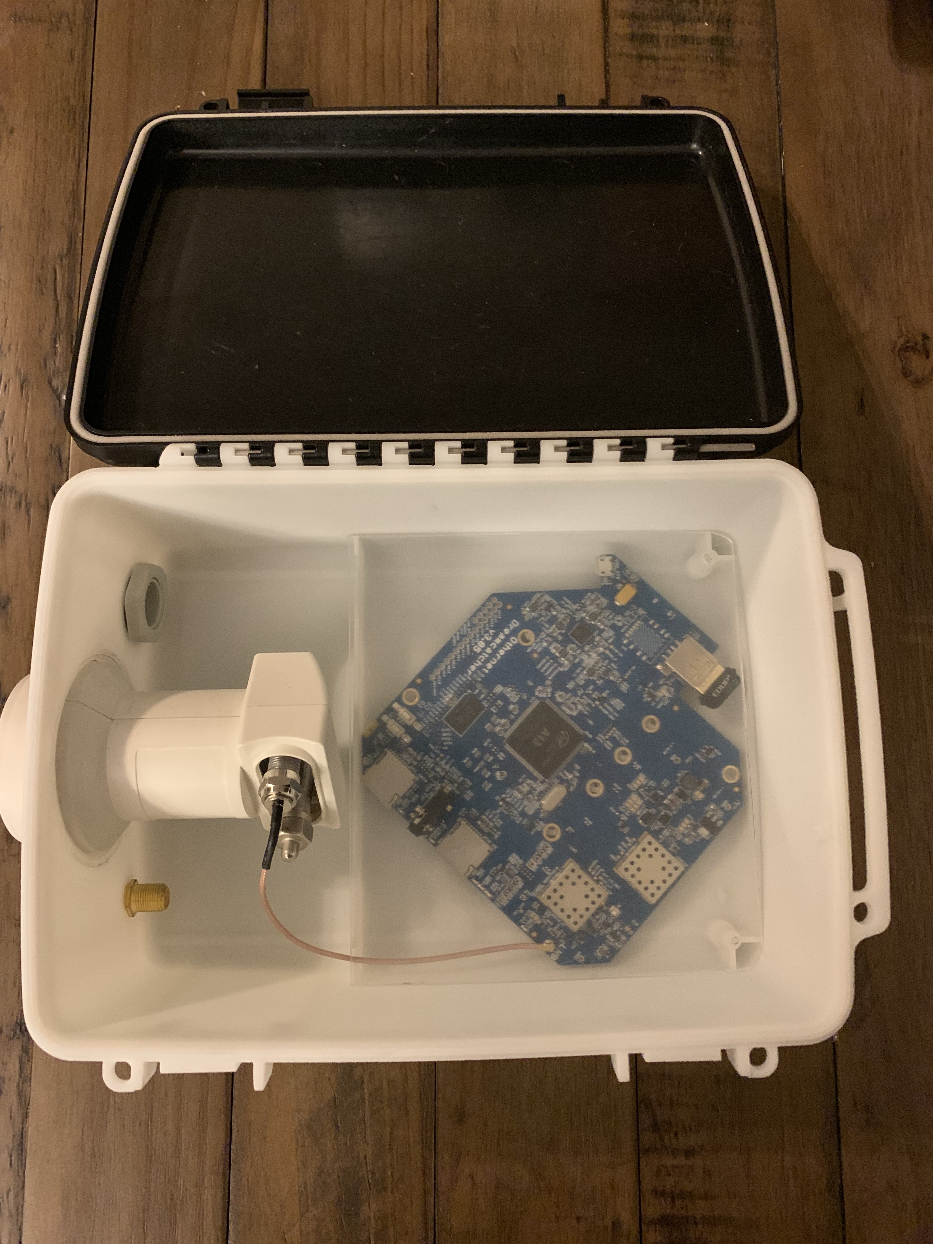

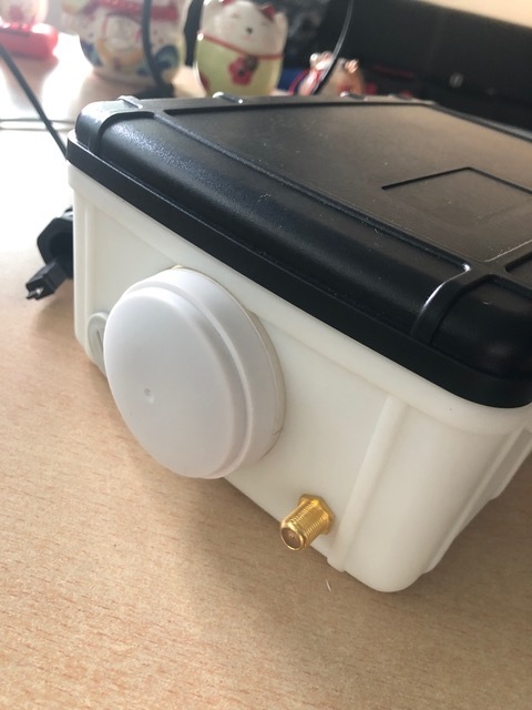

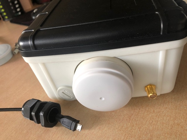

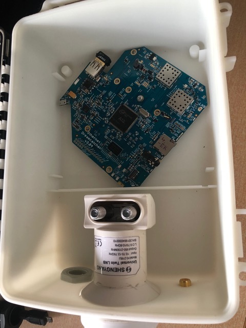

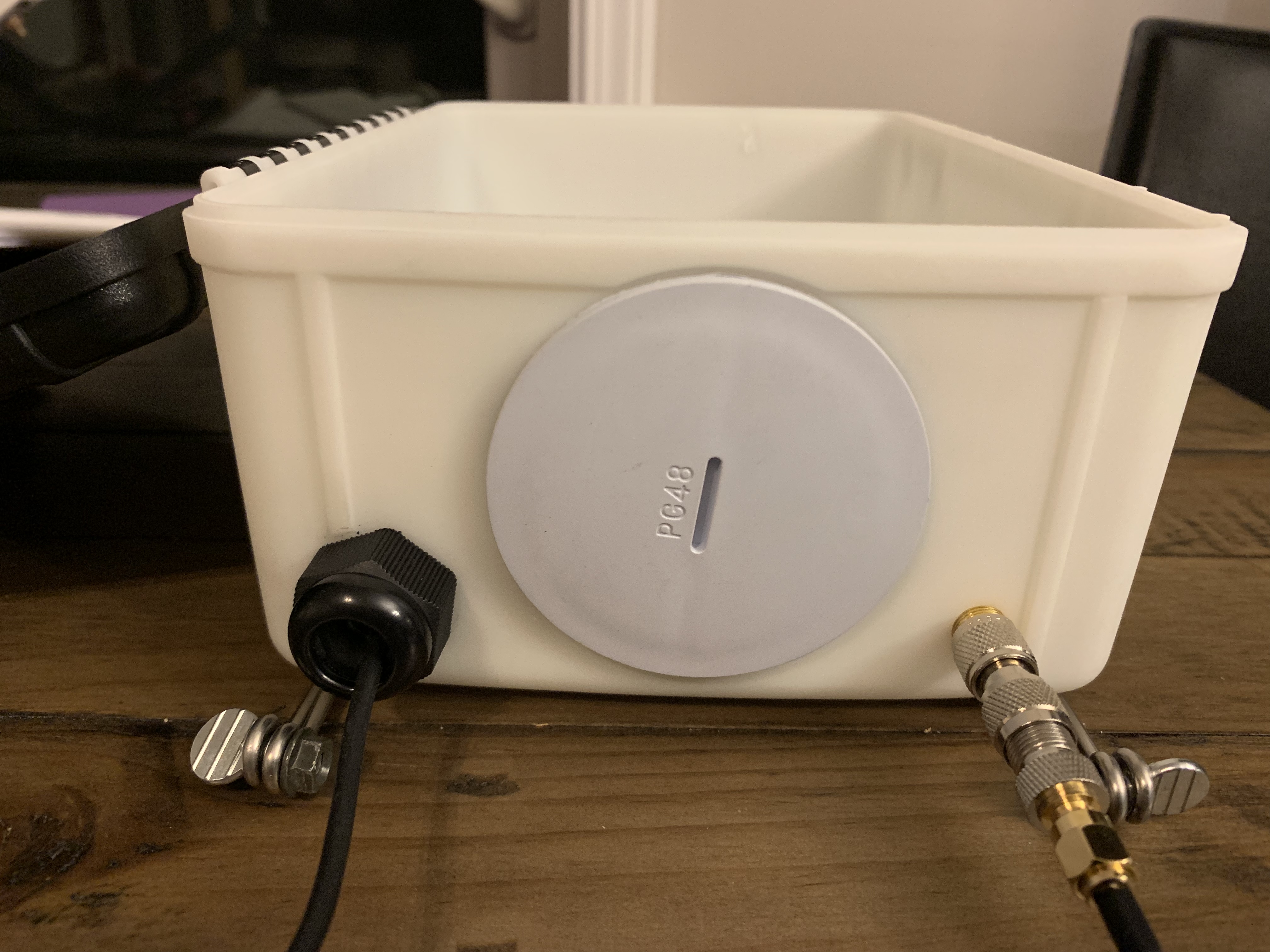

The 3D print of the latest design just came.
Here is what is not apparent from the pictures.

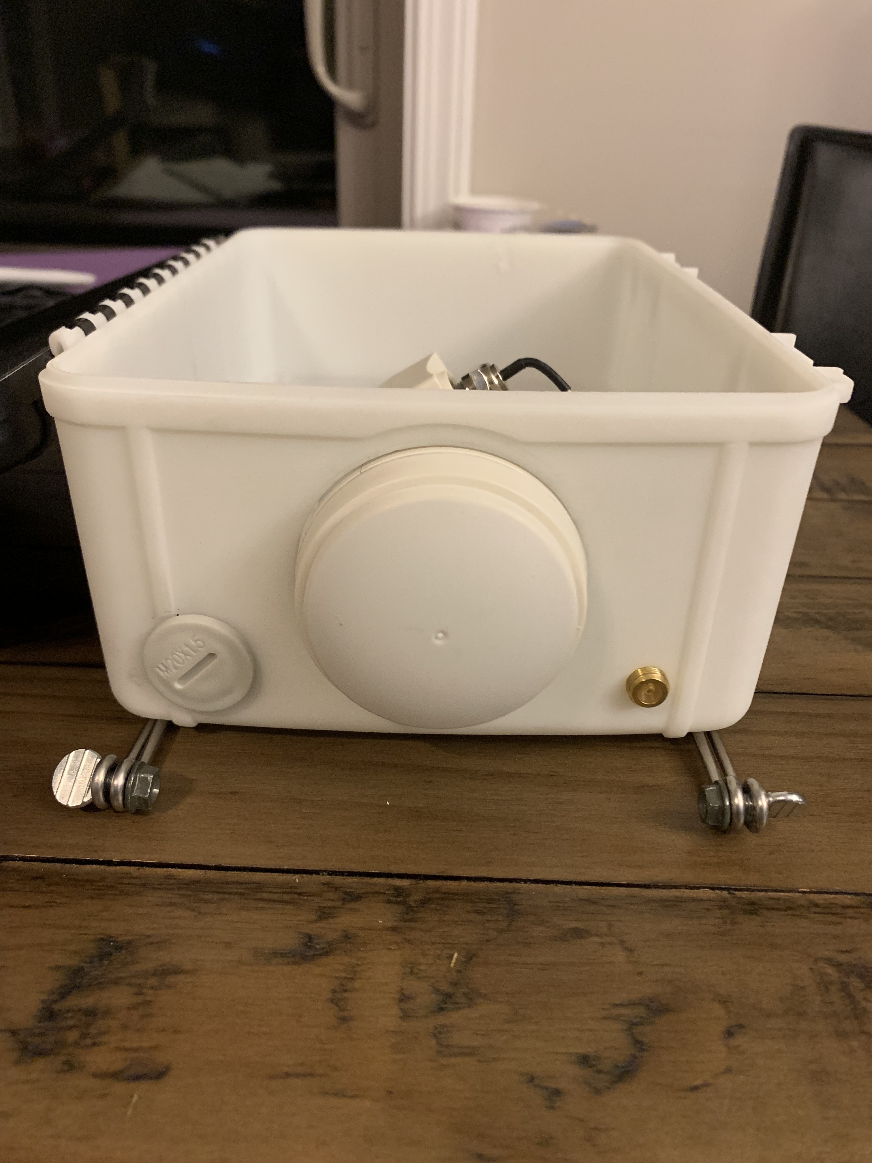

  • The LNB can be twisted/skew-adjusted and stay in place
  • Both of the holes next to the LNB are water tight
  • The LNB can be removed and the hole is closed with a plug
  • The F-connector allows for optional remote placement of the LNB
  • A cover will be placed on top of the Dreamcatcher
  • The bottom allows a stand to be attached for elevation adjustment

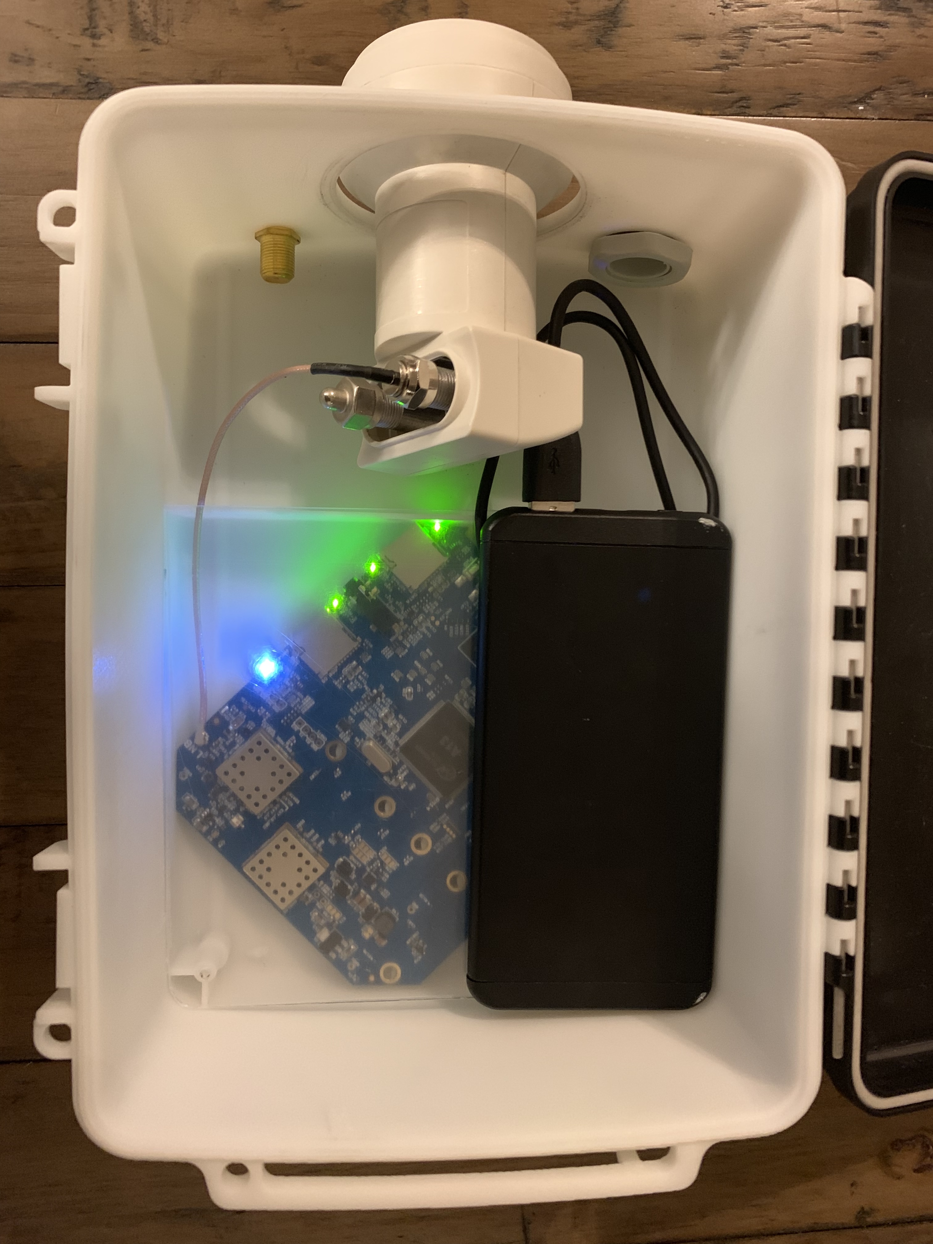

  • There may be foam on top of the Dreamcatcher to hold a battery in place

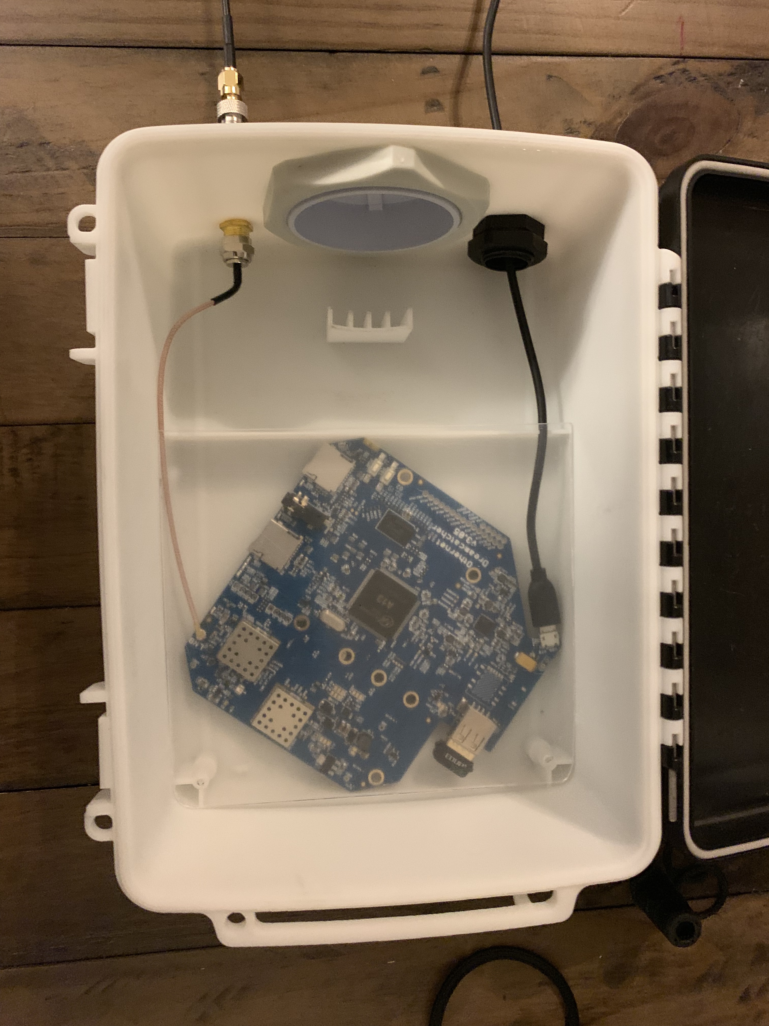

Here is a 3D print of the latest version. Still a few changes left.
My only concern is heat, midday in summer. It’s a shame it’s too big for a Rubicon - OpenH You could then have bonded the cpu to the aluminum.

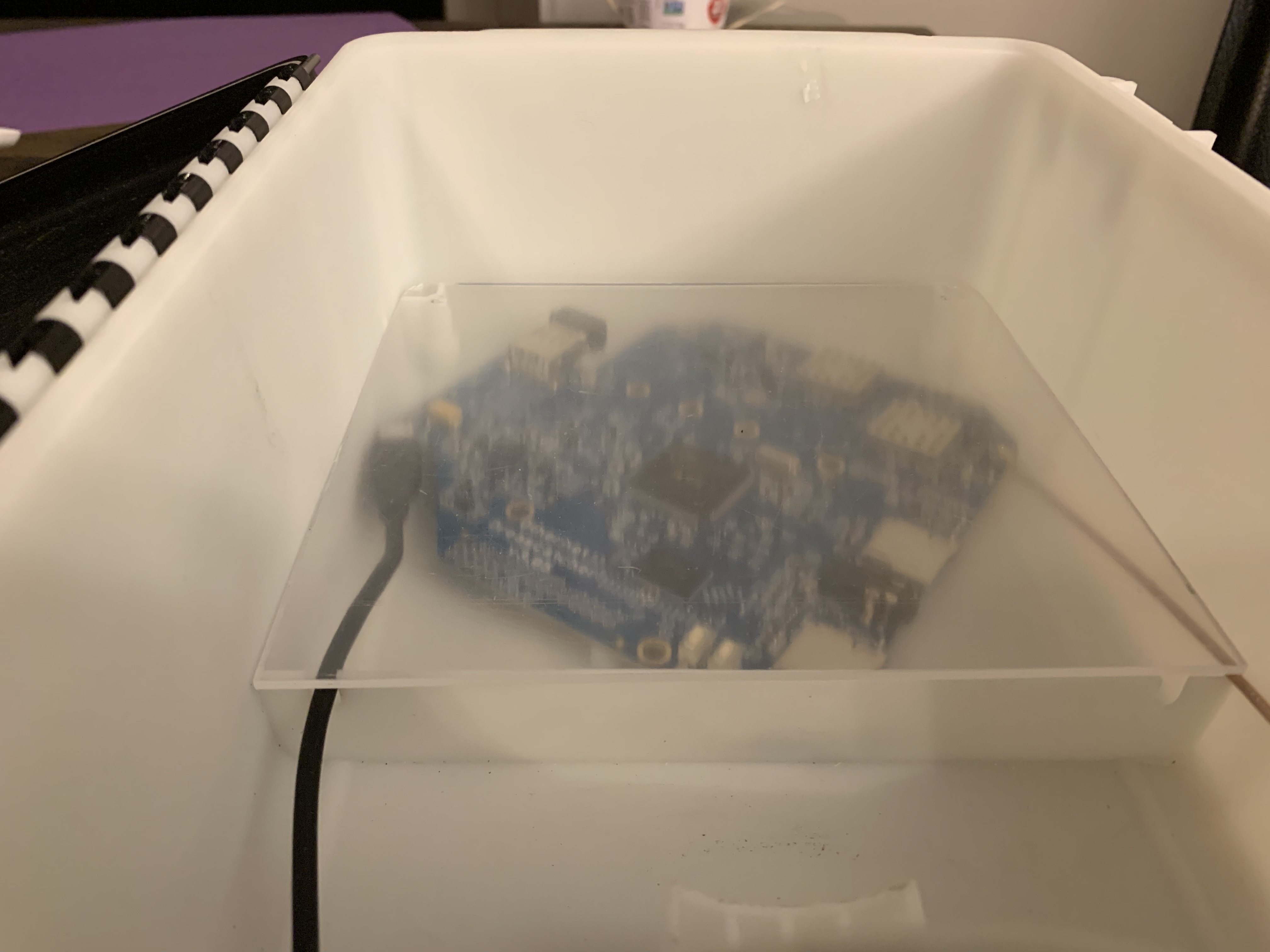

What purpose does the inner case serve? I’d be temped to leave it out so at least you have airflow inside the case and the slightly larger surface area for heat transfer.
Assume you’ll put some desiccant sachet in?
