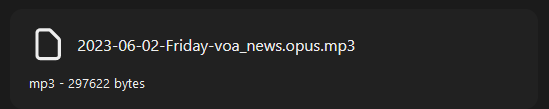

Syed @Syed , are you going to resume the VOA broadcasts? The latest one is
