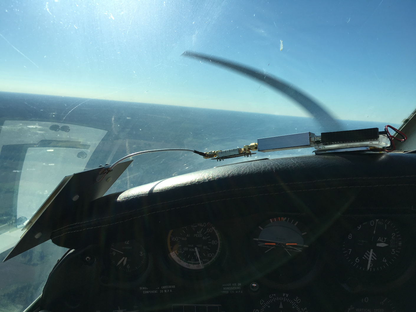

@JAS - I tested it in my airplane, the antenna was pretty well pointed and I still didn’t get SNR above 0.5 dB.
