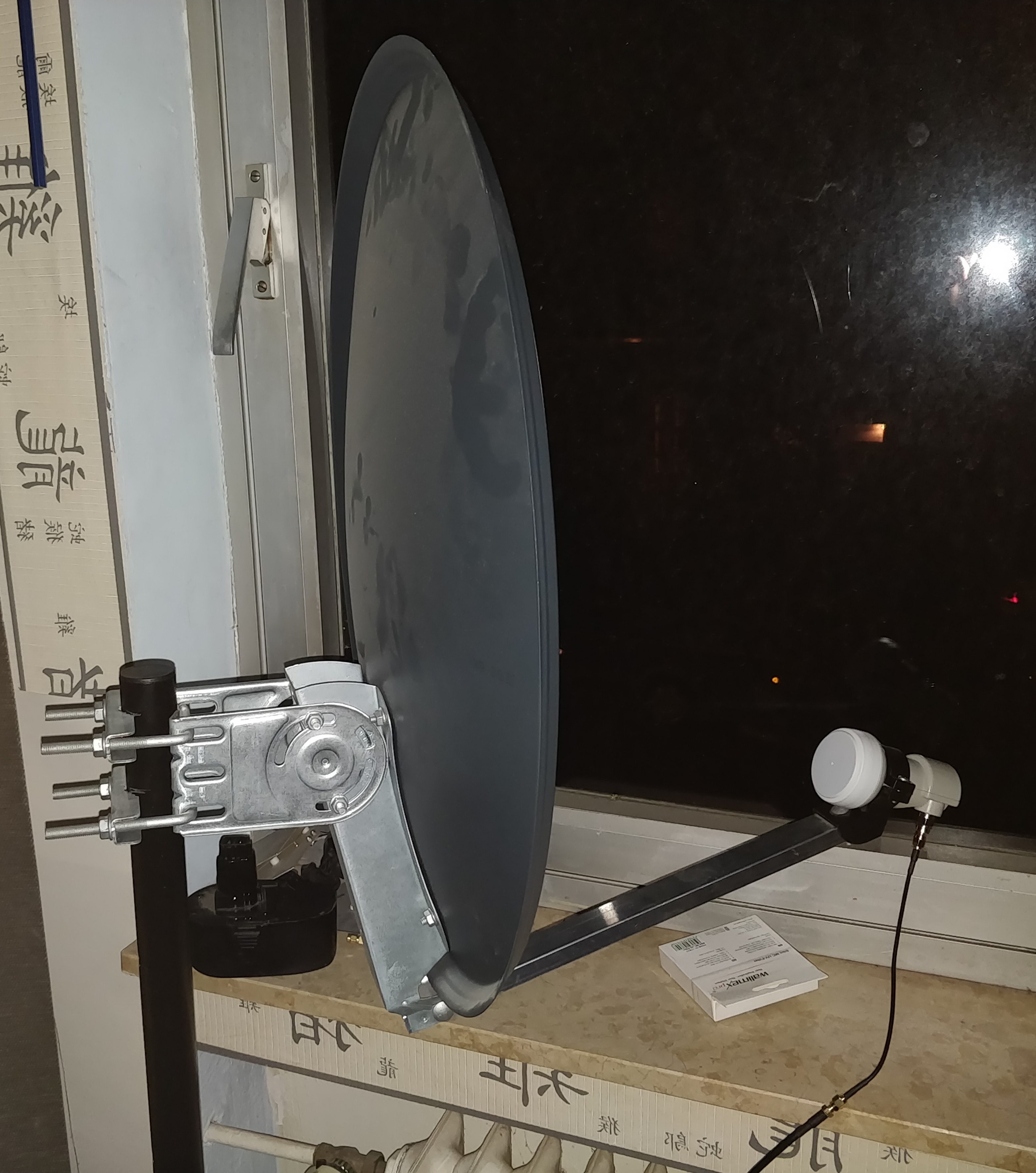

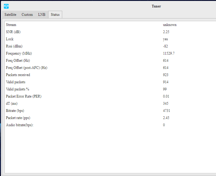

got my DC 3.03 today and after some trouble i was able to get a lock at SES-4 on 22W!
I currently use a 60cm Dish with the Maverick PLL LNB that is pointed trough my Window.
I will adjust some things to try and get a even better SNR, but it is now a solid Lock.
Location is near Cologne, Germany in a residential Area, so there is quite a lot of noise in the Air.
Here some images of my Setup:
Regards,
Manuel - DO5TY

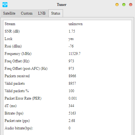

Just adjusted the pointing of the Dish now and i have a SNR of around +1.75!
And that through a double glass window and near a lot of PCs and so on.
The bit rate (5163 bps) is low. @Abhishek will address that with you. It should be about 20000 bps. Otherwise, you are looking good. Ken
bitrate on the EU beam is lower right now - this beam is half the bandwidth compared to the US beam, and lower power as well.
We are working on adjustments which increase speed, but for right now - the stats reported by @Tysonpower are as expected.

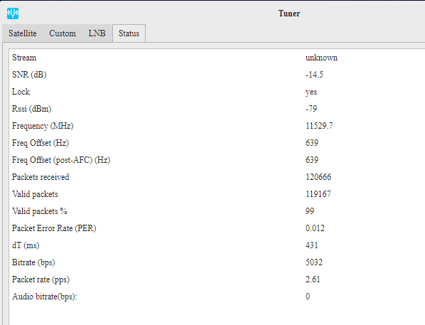

@Tysonpower : it might be time to try without the dish.
So i now turned the LNB around so it is not using the Dish. Same Place as before, but know in the sun that could make the signal a bit weaker due to the temperature on the LNB i think.
Still, i got a stable lock at around -14.5db SNR.
@Abhishek @Syed

@Tysonpower Do you have an specs on the dish? I am guessing antenna gain is about 36 dBi. The MK1 LNB has been chamber tested at 13 dBi, which takes away at least 23 dB from the link budget. But funny enough, you are only seeing a difference of 16 dB of SNR loss.
By how much did you adjust skew on the dish?
The Dish is a 60cm Opticum one that was quite cheap: Wir arbeiten gerade an unserer Website
Gain at 11.7ghz is around 34.8, at least that is stated by the manufacturer,
The skew was at the correct +21° but skew seems to be a bit off without the Dish.
My Signal also got worse a bit (around -16.5), currently playing with the skew a bit.

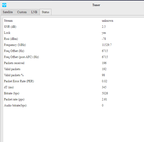

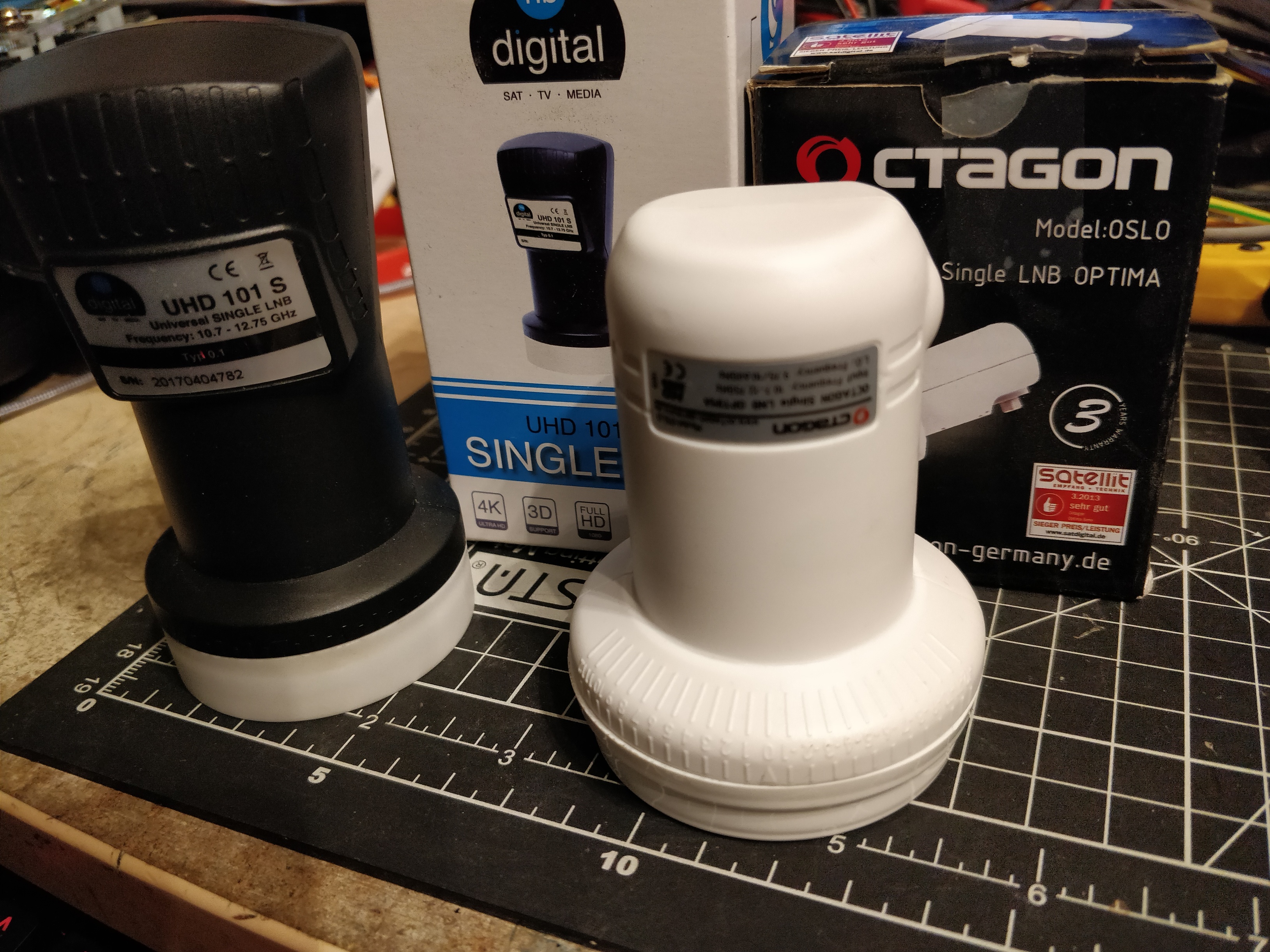

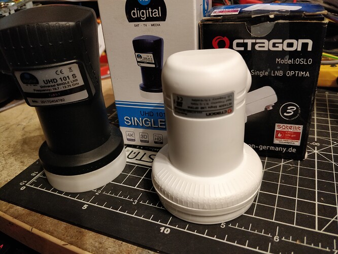

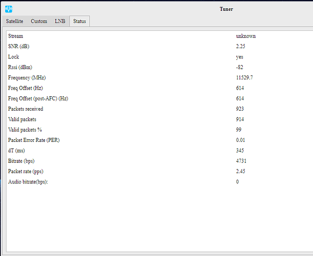

I did some Testing with some other LNBs i had laying around and it seems that, especially with a Dish, you can use almost any PLL LNB. I used the well known Octagon OSLO (used on QO-100 for HamRadio) and some random LNB named “UHD 101 S” that actually came with the 60cm Dish.
Both LNBs cost around 10$.
With a Dish both work really well as stated before (OSLO vs UHD):

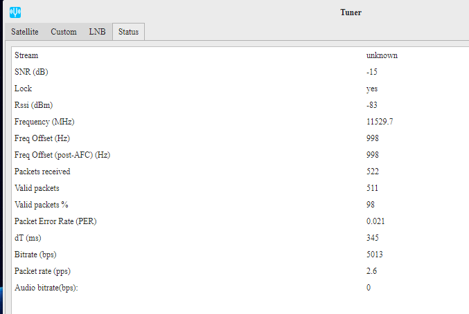

Next test was without the Dish what also worked well (OSLO vs UHD):
Currently Running on the Octagon OSLO LNB without the Dish at around -15db SNR @Syed @Abhishek

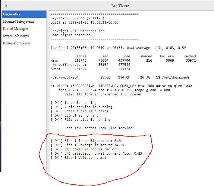

@Tysonpower Danke! It is now set on 11.52970 and beamtype 165. But still no signal. You mentioned you also had some trouble before getting a lock. Was there anything else you had to change? Could the quality of my antenna cable be an issue?
mmm…nope didn’t change anything. Can you check in the log if the LNB is recognised?
Do you have a clear view of the Sat? Also pointed right? Maybe play with the skew and pointing. Where in Germany are you btw.?
I have a clear view. And I am pointed according to the values from dishpointer.com. Also in the log everythin is OK. I just try changing the pointing a bit. Or I will try from another position on Sunday.
