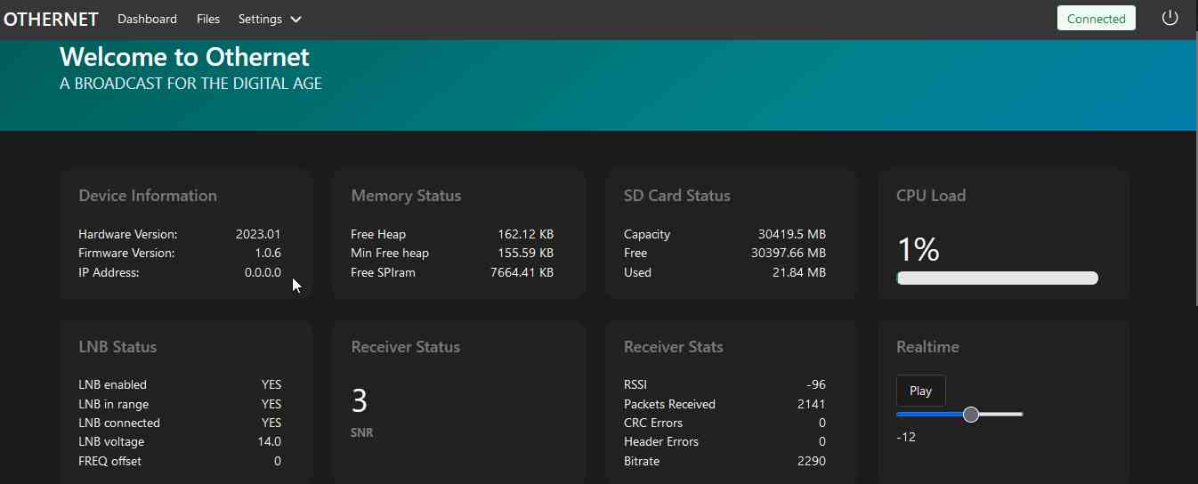

Something happened this morning, an hour or so ago. My DC was running fine, writing files to the SD card, taking downloads. All of a sudden, it acts like the SD card does not exist, all zeros in that column, not downloading files, etc. I re-booted, but still the same. Is the bird off the air?
@maxboysdad That’s strange. Are you still seeing an SNR value?
Yes. 0 to -1. And looking at the files tab, all the accumulated files are missing now, also. It was at around 570 Mb last night.
I just shut it down, removed and re-inserted the SD, re-started it, and it is now functioning again. Ida no, mebbe a crazy old operator.
It is, however, missing around 500 Mb of files it had accumulated earlier, and appears to have had the whole file structure re-written. Also, the downloads don’t seem to be writing to files, either.
