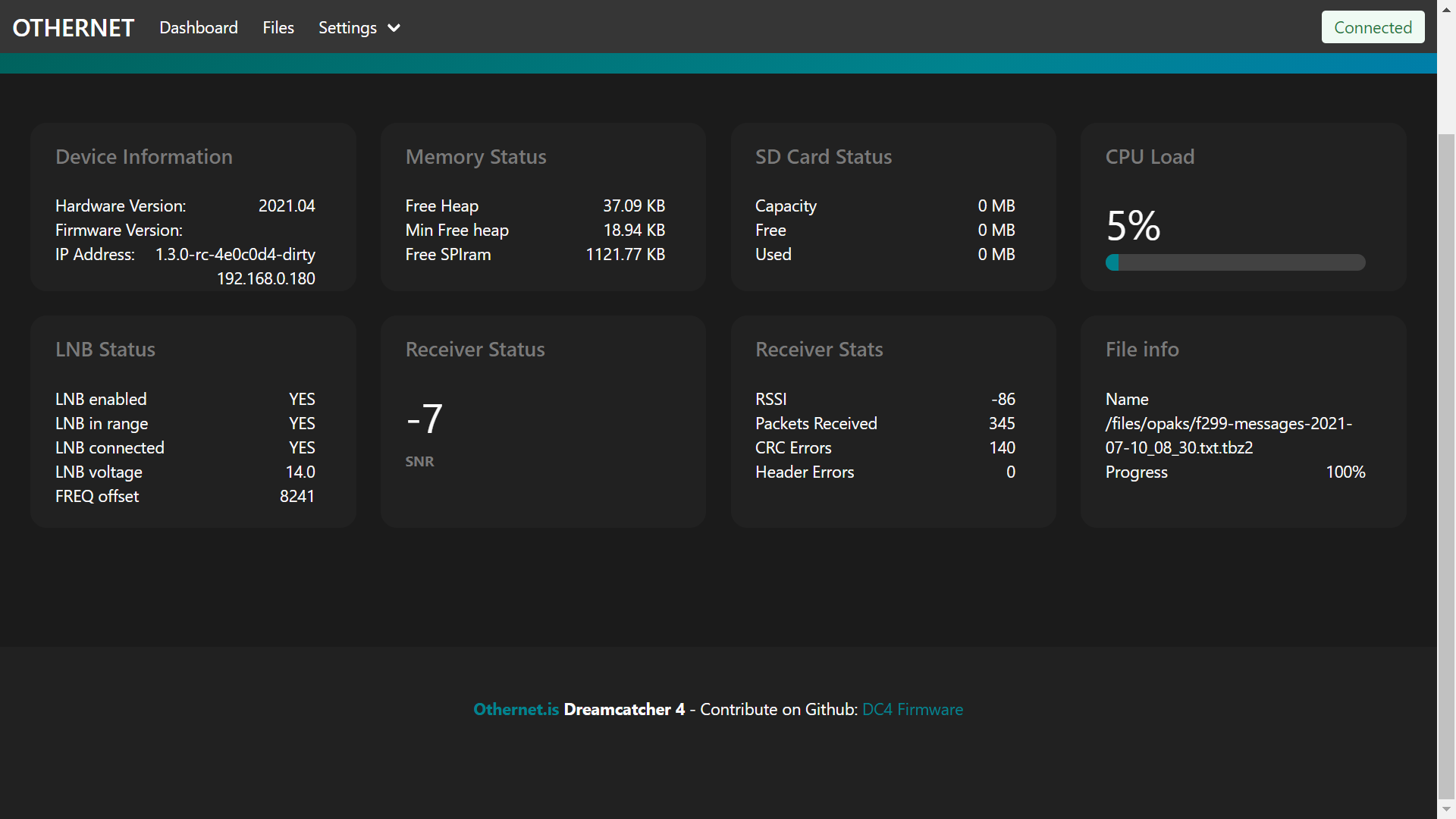

I’m using the most recent firmware posted on Github (the binary blob). For some reason, using the 9750 LO from the LNB is not allowing reception, but when the 22 kHz tone is activated and selects the 10600 LO, reception is possible.
The performance is similar to an old known-good prototype which has no mixer on the Dreamcatcher. The RSSI is a bit lower than I was expecting (-87 dBm RSSI). The SNR is -14, which is likely the cause of the CRC errors. I’ll repoint and to get a better SNR, which should resolve the CRC errors. For the current radio settings, I believe the required SNR is -11.
Tagging @caveman99 and @Tysonpower in case they have any confirmation on their end.
The CRC errors were definitely related to the low SNR. I minor nudge of the antenna brought SNR down to -7. Now I’m getting files.
Dreamcatcher 4 with the integrated LO/mixer might be a bust. Fortunately, we just tested a dCSS LNB that worked really well. Assuming that the dCSS LNB passes another couple rounds of testing, Dreamcatcher 4 will basically be just the SX1280 and ESP32-S2.
