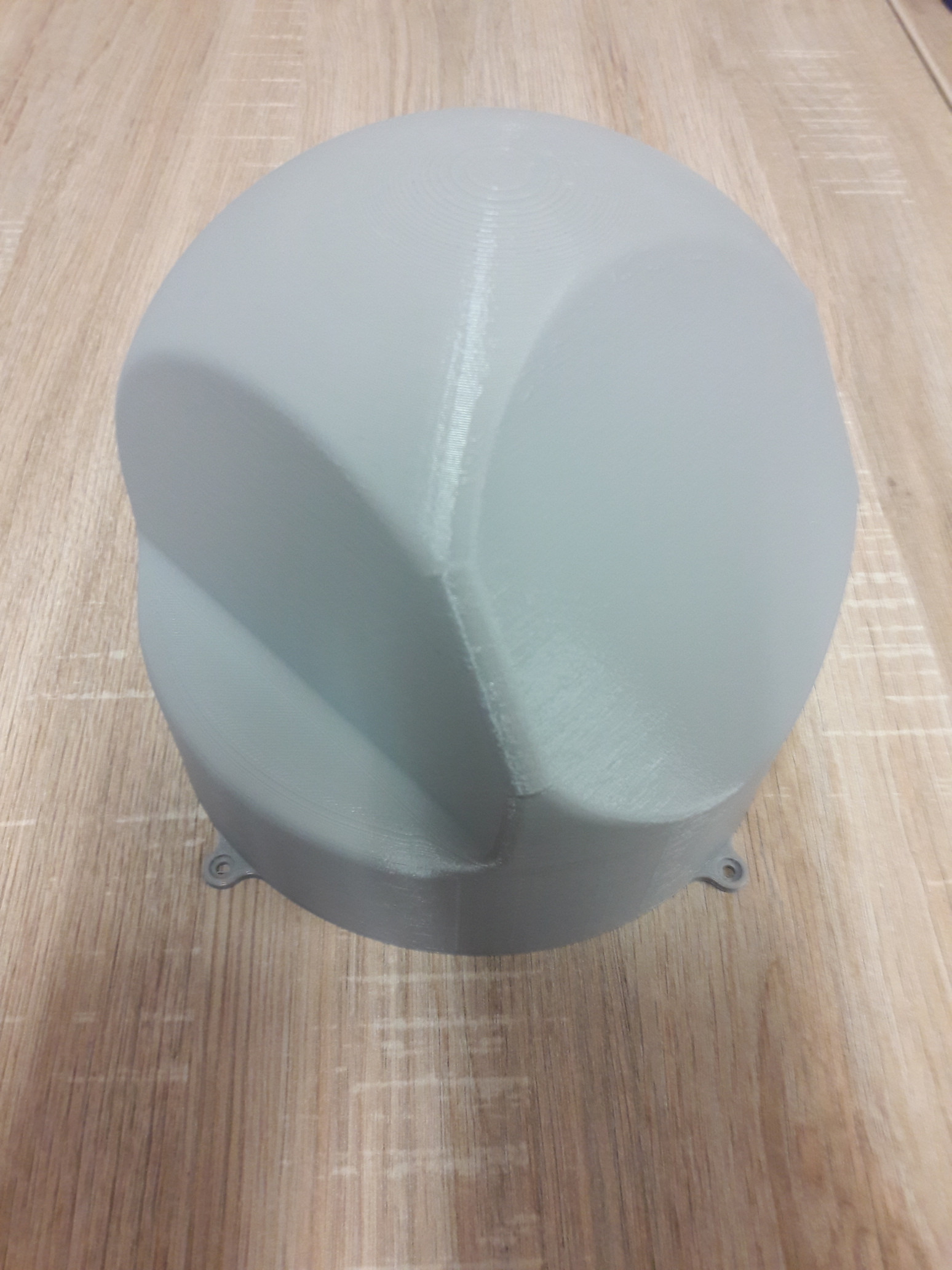

Printed so far the biggest part (RADOME…) with FDM printer Prusa i3 MK3 with supports and looks nice.

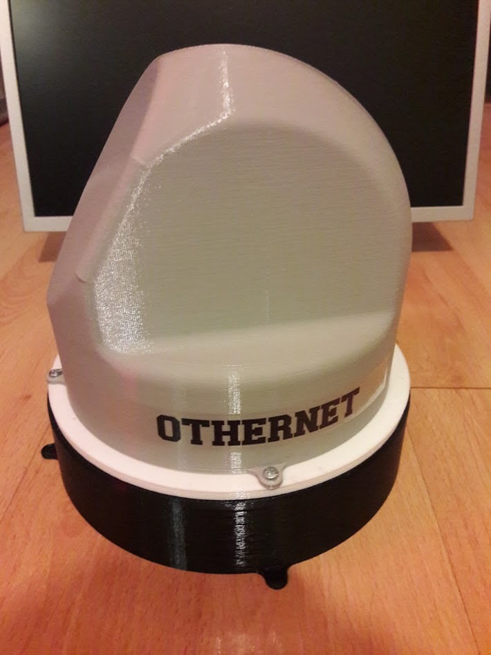

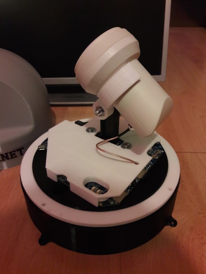

Finished printing. For LNB I had to enlarge the holder ring and add additional space by shifting radome up by 5mm (done by white ring around the original base)
Thanks @Syed for sharing STL files.

Printing was almost straightforward, but be aware, that all STL files except RADOME_9-17-19.STL are in inches (RADOME is in centimeters). I had to design my own LNB holder, CONE-CLAMP-LONG_9-17-19.STL is for LNB with slim head. Based on your location you may need to increase the elevation angle of LNB, then RADOME could be low, so I had to add additional 5mm ring to shift it little bit higher.
I did not print PLATFORM_9-17-19.STL as I’ve designed little bit different with holder for 2x18650 lipos to have it mobile without any wires. But file is correct, I’ve checked it.
I have used PETG and I did not noticed any signal attenuation, SNR was the same with/without the dome cover.
I had it outside on balcony in -20°C ( -4°F ) during the snow without any problem or leaks, just use stainless screws as they are not covered.
