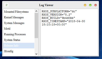

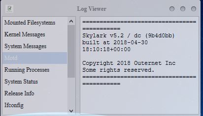

can you please confirm the image booted on 3.03 is 5.2/5.1 and not an older one? The voltage was set to 13v in 5.0 but was increased to 14.2 in 5.1/5.2, to account for longer cable runs.
What does the LNB status tab report? Could you share a screenshot?

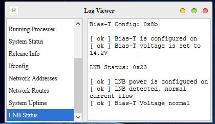

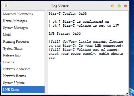

Here are the screen shots - -
With the Maverick connected by 1 ft of cable, the DC 3.03 shows normal Bias-T operation, but of course can’t see the satellite - -
When I go back to the DC 3.02Q, all works well. Any new thoughts? Ken
that last shot - the one showing “voltage set to 14.2” is also from DC3.03 with the 5.2 image? or is it from DC3.02?
That’s the DC 3.03 with Skylark 5.2 connected to the Maverick LNB 1 foot away from the board. My DC is in the house 500 feet away from my Ku LNB/Dish out in my antenna farm. Ken
There is something very wrong. the first shot (the one showing Bias-T config 0x08) is basically saying the LNB power chip is not controlled by the cpu, and has reverted to its default setup of 13v.
The last shot shows everything normal.

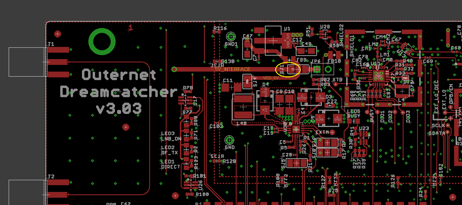

Hi Ken,
Can you please measure the voltage at this point (to GND)?
Left side of SJ1:
This is where the USB 5V arrives into the LNB PMIC. There is an option to use external power source, might this will be the case for you as the long cable makes a bit trouble here. Later will explain that after your measurement.

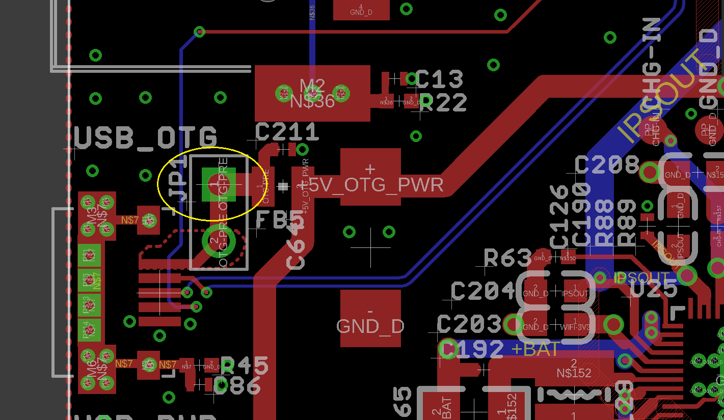

Also please measure the USB 5V right after the micro USB connector here:
