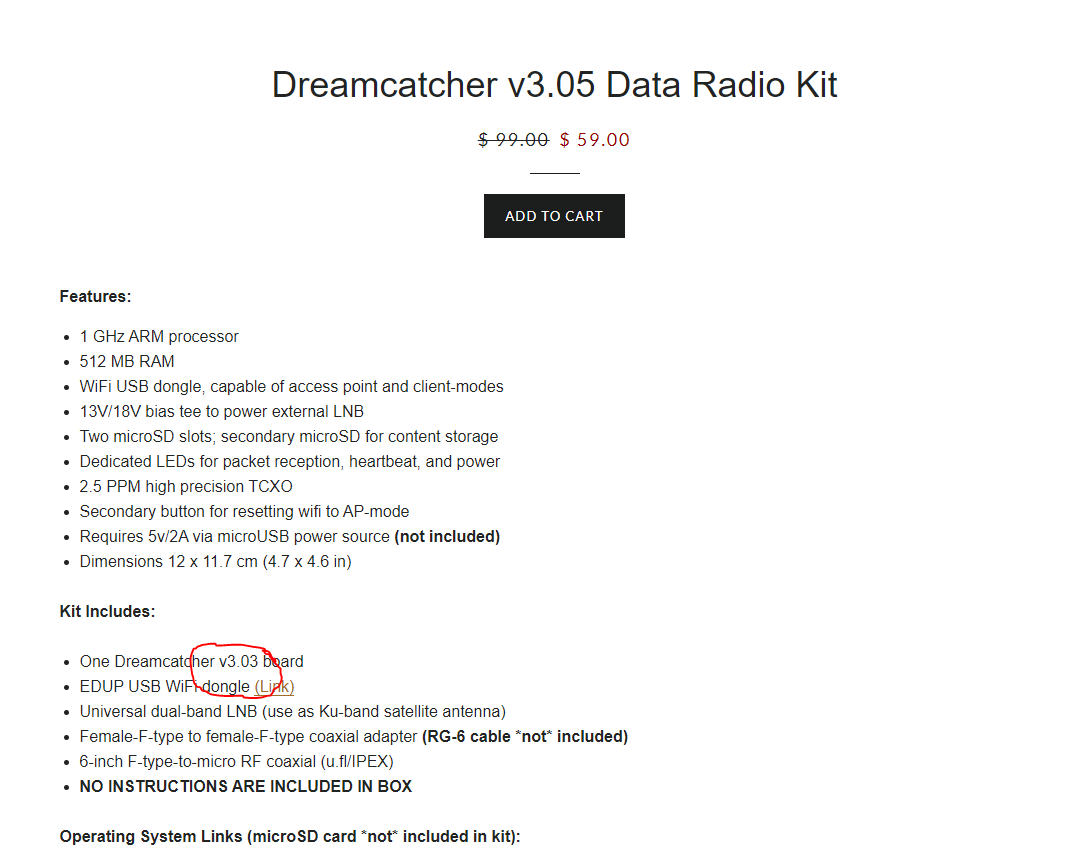

Nice! Also found an error in the listing:
Thanks! Just updated it.
