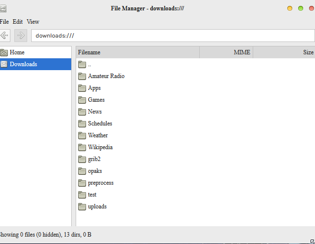

I know when these files come down, you see then in the What’s New Icon. Will we have to go to the Files Manager Icon and then find them there somewhere? Ken
