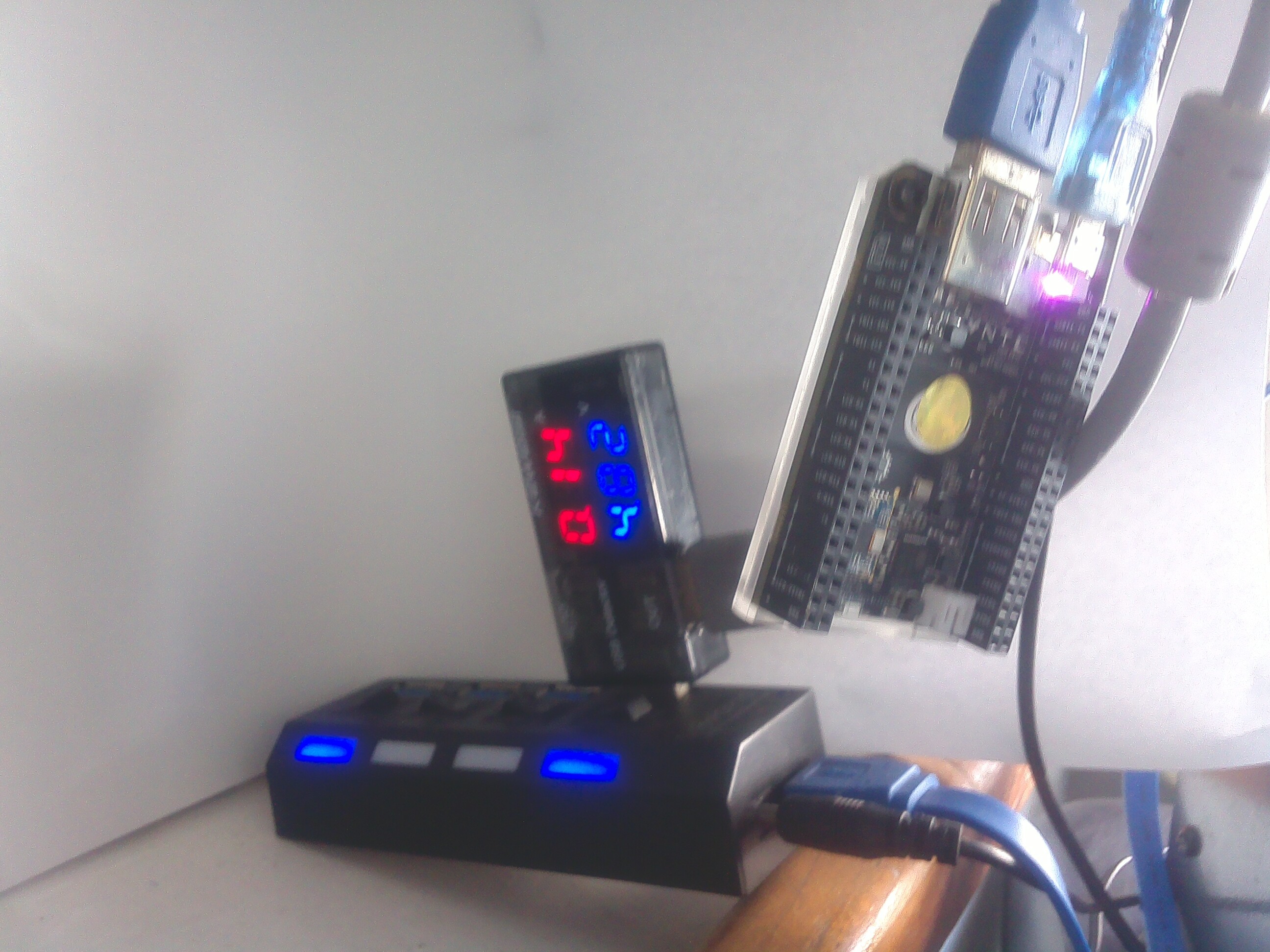

Charging then deploying. But I use an external LiPo charger.
It ran for quite a few hours on battery after this.
Charging via micro USB seems to be extremly slow (when the lantern is on)
even when connection a 2 amps supply.
